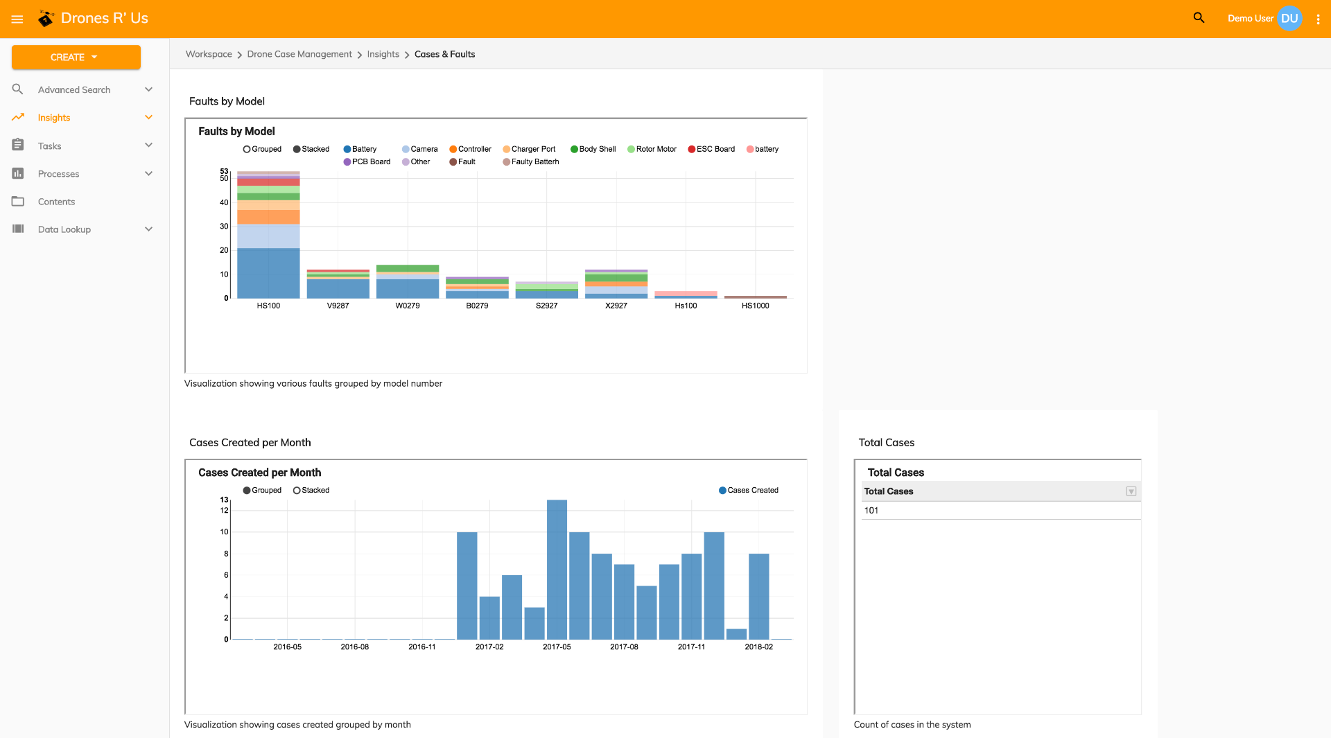

I just saw this thread for the first time and thought I'll add an example approach which we took recently for a demo which we built on top of Alfresco Process Workspace aka APW (OOTB ADF based app with APS) and leveraging some components of ACA . In this case I leveraged the "App" container in APS as a case container. Then used the app.config.json in APW to determine the things I want to include/exclude in each Apps. An example entry in the app.config.json show below. Hopefully this will help someone develop case management style apps using ADF!
"1001": {
"name": "Drone Case Management",
"defaultLandingPage": "insights/support-cases",
"showOOTBDashboards": false,
"apsApp": true,
"showInsights": true,
"showProcesses": true,
"showTasks": true,
"showCreateTask": true,
"showCreateProcess": true,
"showContents": true,
"showAdvSearch": true,
"showDataLookup": true,
"accordionGroups": {
"insights": {
"default": "support-cases",
"items": [{
"id": "support-cases",
"name": "Cases & Faults"
"id": "sentiment-analysis",
"name": "Sentiment Analysis"
"advsearches": {
"default": "case-search",
"items": [ {
"id": "case-search",
"name": "Search Cases"
"id": "fault-search",
"name": "Search Faults"
"id": "recall-search",
"name": "Search Recalls"
"id": "repair-search",
"name": "Search Repairs"
"datalookups": {
"default": "models",
"items": [{
"id": "customers",
"name": "Customers"
"id": "models",
"name": "Drone Models"
The above config resulted in..
