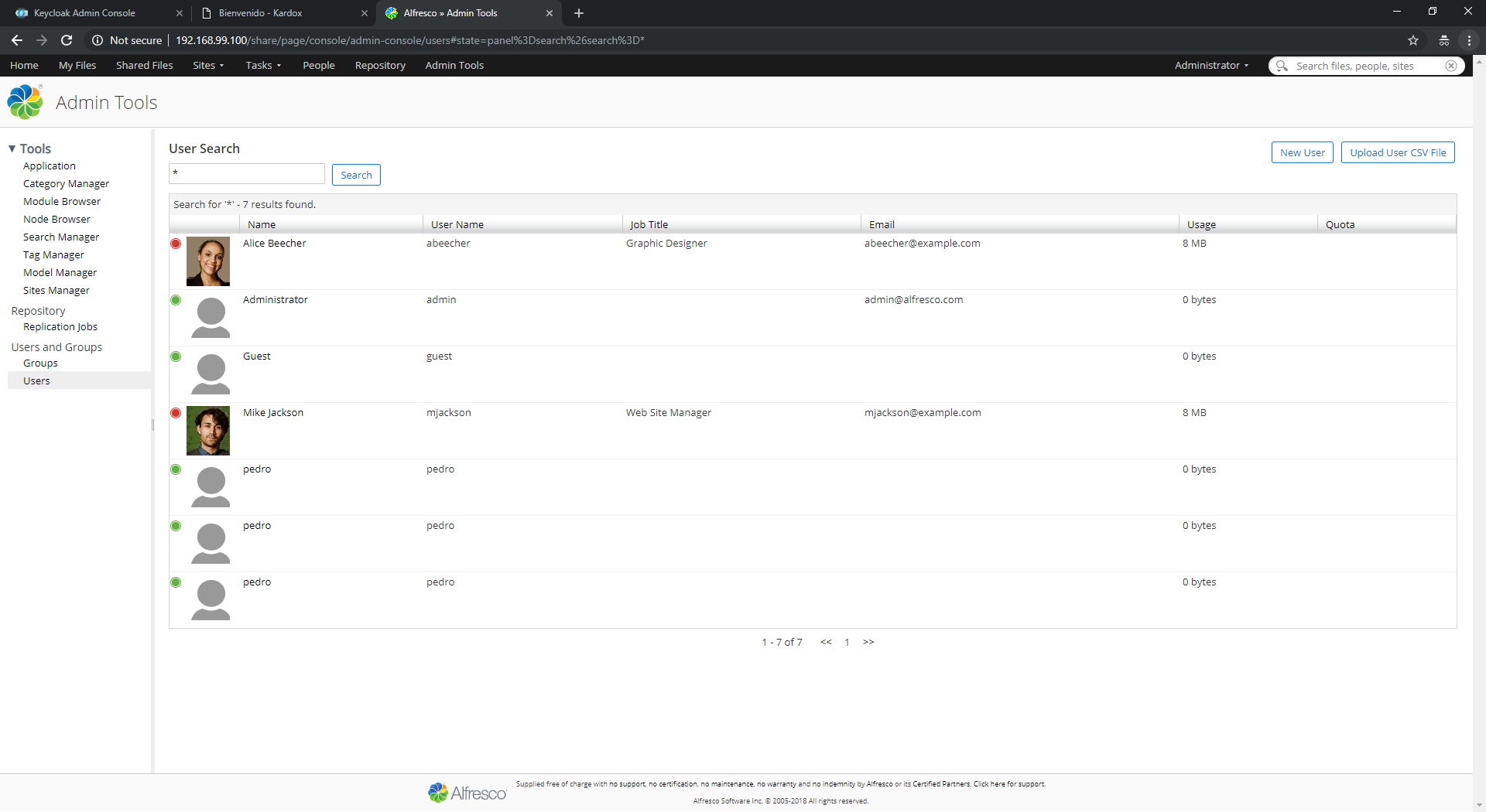

We are implementing authentification with keycloak version keycloak: 4.8.3. Final, and we're having the issue that when logging in with any user, it enters in a loop while logging and it creates several duplicate users in alfresco, we wanted to know if this a known issue or maybe my configuration is wrong. find images below, also we're deploying the applications with docker, if you need futher information let me know. thanks:
PD: image shows how user Pedro is duplicated 2 times.

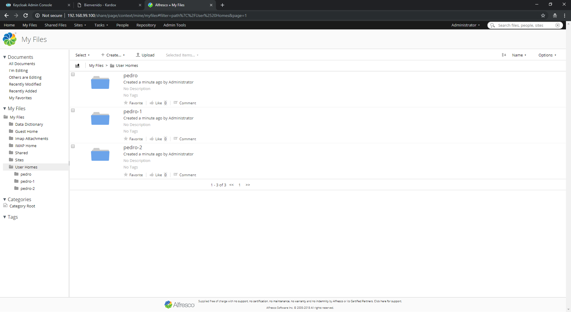

PD: Also it creates a folder for every duplicated user.

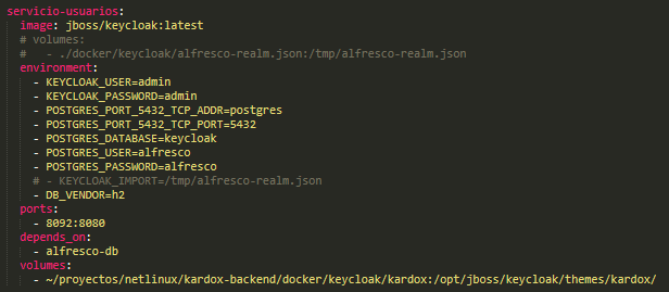

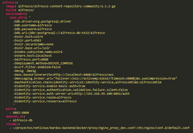

Docker configuration looks like this:

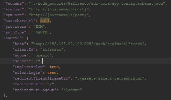

ADF configuration looks like this:

Interesting... it shouldn't actually be possible to create users with exactly the same name due to uniqueness constraints on the user name. I would bet this may not be a known issue (did you search JIRA for it?), since 6.1.2 GA is quite a new release and not a lot of people are using Alfresco with Keycloak yet, especially since Share does not support it for single sign-on purposes.
