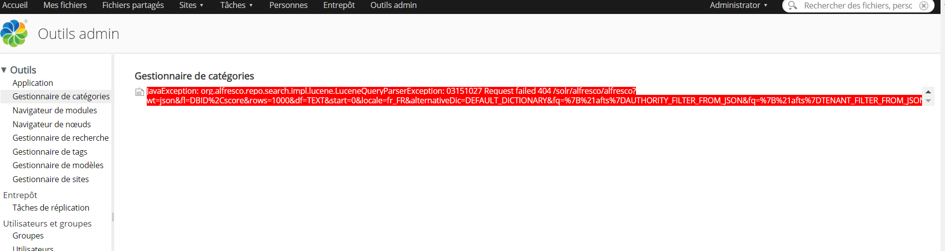

i need your help to fix this issue below.
I have installed Alfresco Community 23.4 and Alfresco Search Services 2.0.14 on Kubernetes. However, I am experiencing an issue with the search feature. Please find the error message from Share below.
capture from Share:
Message error:
JavaException: org.alfresco.repo.search.impl.lucene.LuceneQueryParserException: 03151027 Request failed 404 /solr/alfresco/alfresco?wt=json&fl=DBID%2Cscore&rows=1000&df=TEXT&start=0&locale=fr_FR&alternativeDic=DEFAULT_DICTIONARY&fq=%7B%21afts%7DAUTHORITY_FILTER_FROM_JSON&fq=%7B%21afts%7DTENANT_FILTER_FROM_JSON.
Thanks in advance.
