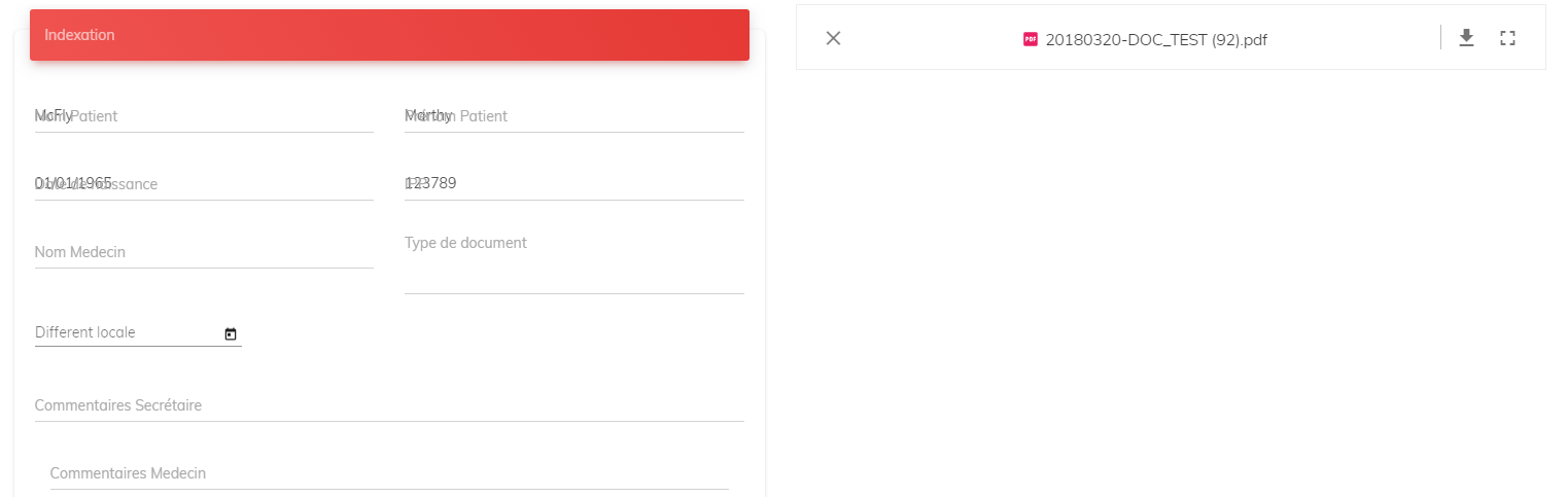

I try to show pdf content in modal :
<div class="col-md-6">
<adf-viewer
[fileNodeId]="docNodeId"
[showViewer]="true"
[overlayMode]="false"
[showToolbar]="true">
</adf-viewer>
</div>
</div>
If i set overlayMode to "true" it shows the viewer as full page.
But if I set it to false, i get only toolbar :
How can I resolve it ?

Hi, It's difficult to say like that. It could depend on your app styles
Could you produce a sandbox to try, with the same issue?
04-24-2018 09:43 AM
You're right, there is too much css ans scss files in my project...I have found the problem but now, I get other style problem...I use bootstrap, material and alfresco css/scss files. so there are some conflicts.
