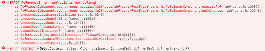

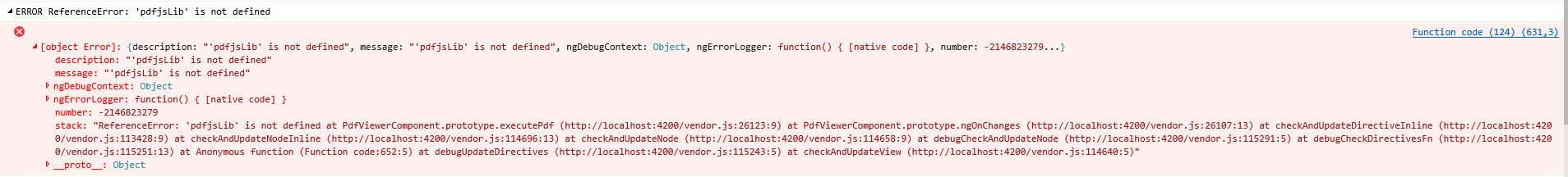

After generating a new ADF 2.6.0 app with Yeoman, when I try to preview a document I get the following error:
'pdfjsLib' is not defined
main.ts contains the following lines:
main.ts
import * as pdfjsLib from 'pdfjs-dist';
pdfjsLib.PDFJS.workerSrc = 'pdf.worker.js';
Sticking to 2.5.0 for my app

The lines are removed, but the error is still active. Smiley Happy
