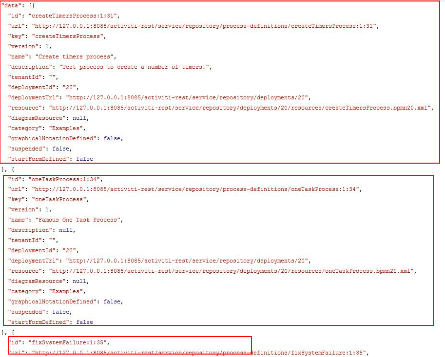

Yes I can see some process definitions as depicted below:
The processes above have been exposed and available when the http://127.0.0.1:8085/activiti-rest/service/repository/process-definitions?size=1000 URL is hit,

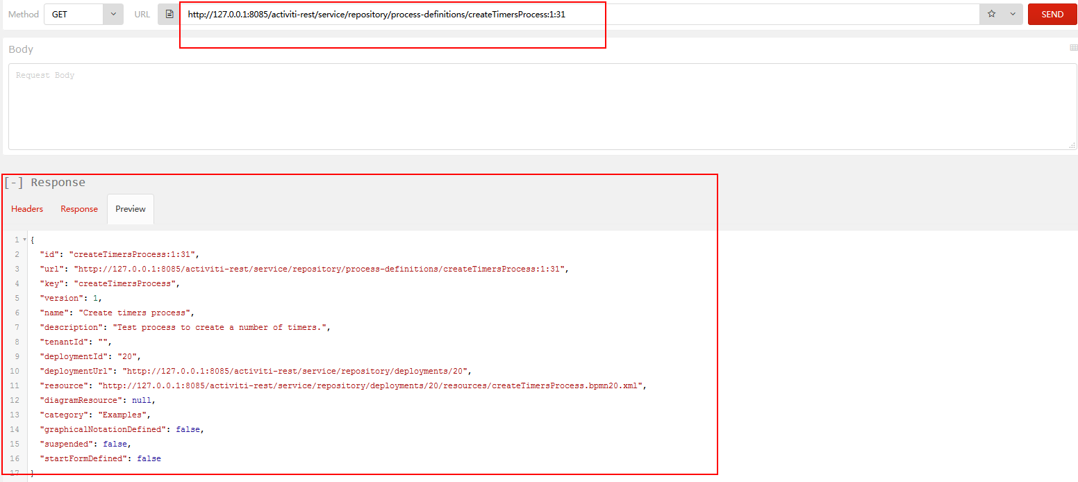

any one of the processes can be exposed by hitting the URL in the rest client : http://127.0.0.1:8085/activiti-rest/service/repository/process-definitions/createTimersProcess:1:31

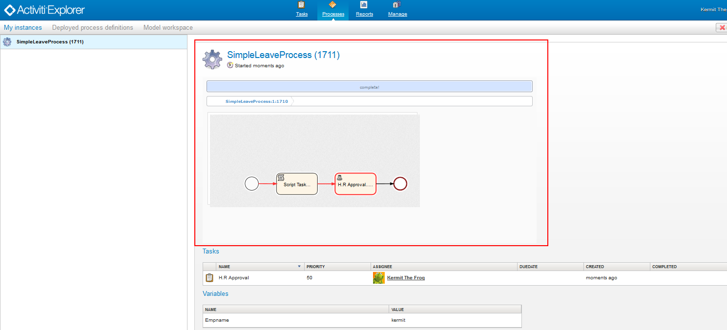

One of the processes I created, deployed and ran successfully in activiti-explorer as depicted below :
But I cannot expose this process via Rest API similar to the above processes.

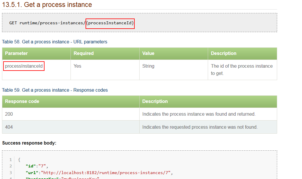

So you are able to start process instances for this process from the explorer? If so maybe check whether you can see those instances from the REST API (Activiti User Guide )

Yes I am able to start my process from activiti explorer. But I am not able to understand from where i can find the instance/process id as it is 31 for the process http://127.0.0.1:8085/activiti-rest/service/repository/process-definitions/createTimersProcess:1:31, similarly how to find out the process instance id as described in the guide you have indicated as -
How to get the processInstanceId value for my process.?
