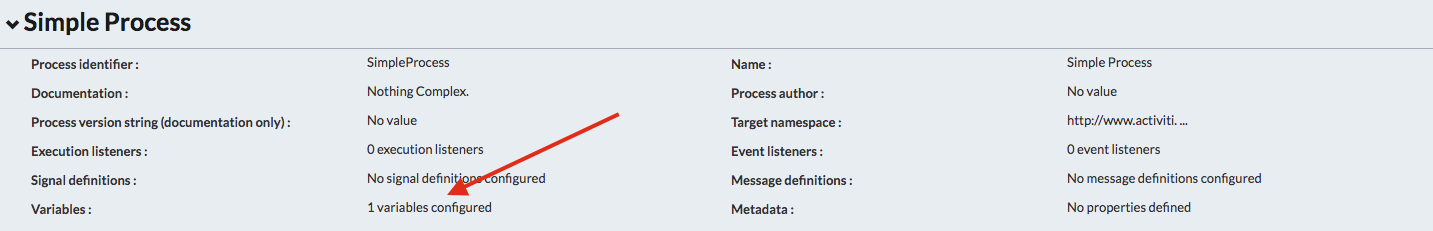

I believe when you use: execution.setVariable("msg", message), that's meant to set a Process Variables. From my understanding Activiti will not define a new variable for you if it doesn't already exist in the process, for example that "msg" value in your script. You would need to have a Process Variable named msg in order to store that information there.
Below is a GUI method for declaring a process variable:
Feel free to look into the Variables section of the User Guide for more specifics on utilization and declarations.

Hi Jonathan,
I looked out for the Variable in the GUI shown above in your screenshot, but my designer doesn't show that option.
I'm currently using Activiti Explorer 5.22.
Thanks.
