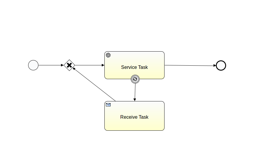

Hi all,
we also want to add this functionality to our project. Our use case is to retry a failed service task without restarting the whole workflow. Moreover this functionality shall be accessible via a REST call.
I've made some research and found that this feature has already been asked quite a few time.
How to implement restart/pause/resume in Activiti
The last link gives some unit test and code for a 'RestartInstanceActivitiCommand'. However I'm not able to integrate it to our use case.
The current solution I'm investigating is by using an error boundary event to catch the service task failure. This error boundary event is linked to a receive task waiting for a signal to restart the service task, as the following figure illustrate :
This diagram work well, as we are able to successfully retry the service task when it fail, but the workflow does not seems to reach the end event when the service task is finally successful. The process instance isn't ended.
Any hint or advice for another strategy in order to implement this feature will be greatly appreciated.
Best Regards.
