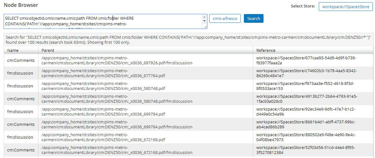

Hi All,
Im using node browser and my query is SELECT cmis
bjectId,cmis:name,cmis
ath FROM cmis:folder WHERE CONTAINS('PATH:"//app:company_home/st:sites/cm
ims-metro-carmen/cm:documentLibrary/cm
ENZ50//*"') where I will go to the specific folder where it contains pdf file while using that query it directly displays (please see photo below)

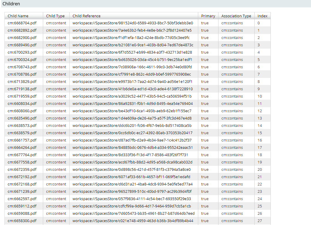

instead all I want is just to display directly the children of the specific folder in which you can see the photo below,
Is this possible? Thanks

You should select for cmis:documents instead of cmis:folder to list the documents.
Also, there is a far better option than using CONTAINS + PATH to select by a common ancestor. CMIS has the IN_TREE operator to select anything below a specific base folder. You'd just need to resolve the base path against the folder ID and user that as a parameter to IN_TREE.
