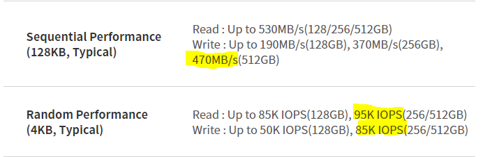

How about the disk performance?
My computer is by far worse than yours, but it has a SSD, and the performance is good enough.

‎12-20-2017 08:15 AM
Mine also has SSD.
