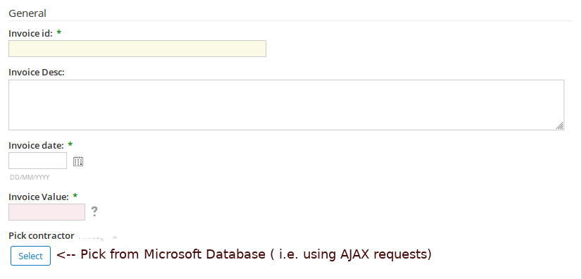

I have database in Microsoft Dynamics which stores buyers objects.

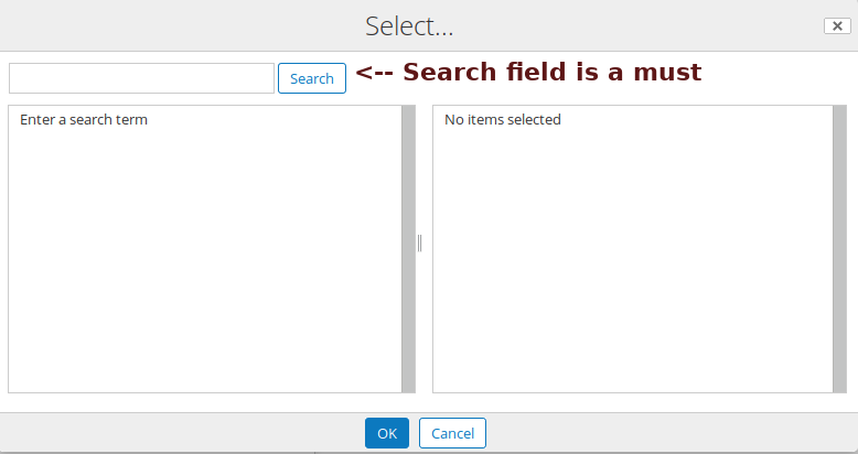

Now, in my workflow task form, I would like to create a custom control, which will allow me to pick one buyer from that database. I also need a search field, just like when picking an authority (authority.ftl).
How can i create "outside" AJAX requests from this picker?
