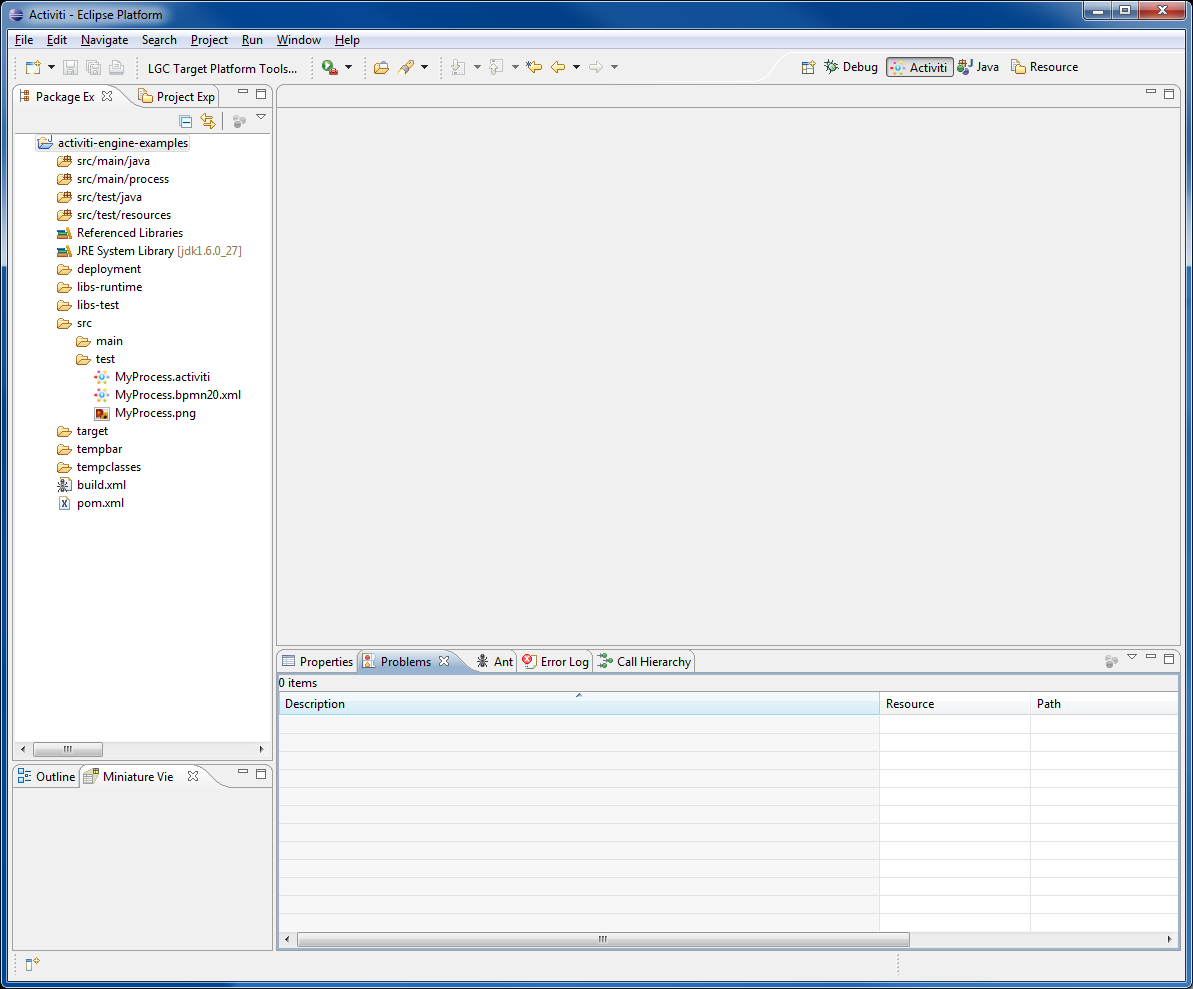

After following the eclipse setup instructions in the user guide I added my own process to src/main/test in the activiti-engine-examples
Then i deleted the activiti-engine-examples.bar and activiti-engine-examples.jar files from the project.
Then I tried using the MB3 option Create Deployment Artifacts to create a new bar and jar files but nothing happens when I do that.
No indicator/progress nothing and no bar or jar files are created.
There is nothing in my problems view and nothing in the error log. The xml seems to be fine.
Ive attached an image of my eclipse workspace.
Can anyone please help me figure out whats going on.
Thank you.

your processes should be placed in src/main/resources/diagrams. not in src/main/test . That's probably why creating the deployment artifcact does nothing: it doesn't find any processes in your project.
